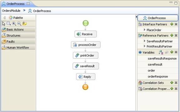

The business process “OrderProcess” invokes the reference partners “PrintResult” which uses “PrintResults” interface and “SaveResult” which uses “SaveResults”:
When an input message arrives, the business process computes the output message and invokes “printOrder” and “saveResult” partners. Then, it sends the reply message back to the invoker:
