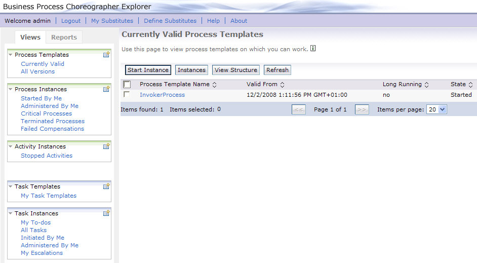

To start the invoker process, follow these steps:
The Currently Valid Process Templates view is displayed:

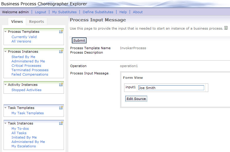

The Process Input Message view opens:

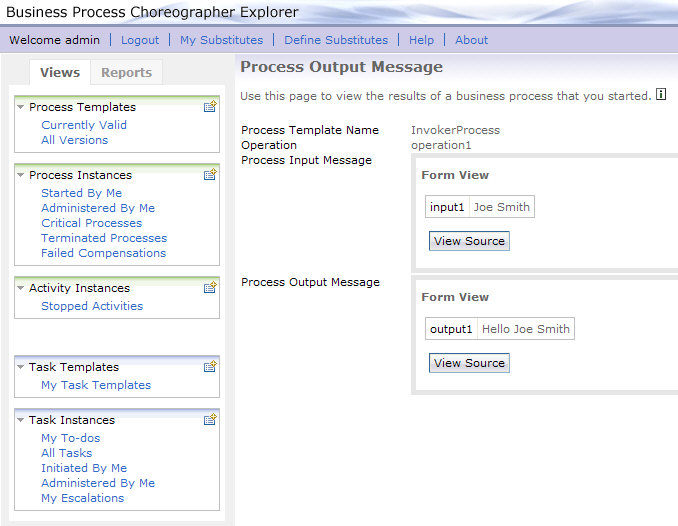

Since the invoker process is a microflow, the process output message is displayed immediately after the process input message has been submitted:
Inspect the SystemOut.log of your WebSphere Process Server or the Console within WebSphere Integration Developer. The HelloService prints statements similar to the following:
[11.23.07 12:32:19:591 CEST] 00000093 SystemOut O HelloService.hello(String name): value of name: Joe Smith
