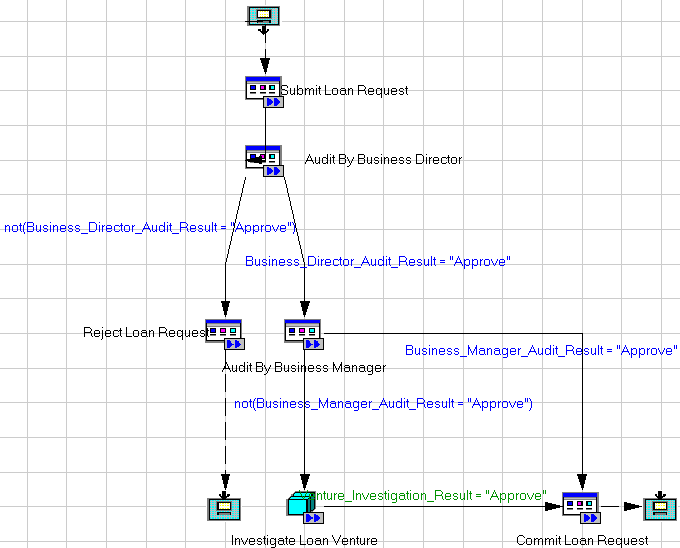

Business flow:
The following diagram shows the monitored business flow.
Root Process: Loan Request Process
Block: Investigate Loan Venture

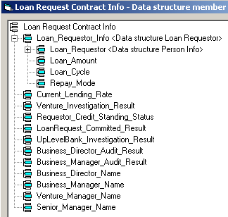

Data structure used in the FDL:
There are three types of data structures: Person Info, Loan Requestor, and Loan Request Contract Info. These data structures are used as the input or output data of every activity. Loan Requestor contains a member type of Person Info and Loan Request Contract Info contains a member type of Loan Requestor.
Person Info:
Loan Requestor:
Loan Request Contract Info:

For the root process - Loan Request Process:
(The loan request needs venture investigation) The loan requestor submits the loan request and waits for the business director's approval. If the business director approves the loan request, the loan requestor continues waiting for the business manager's audit result. If the business manager does not approve the loan request, the venture of this loan request must be investigated and the process goes to block "Investigate Loan Venture". The "Commit Loan Request" activity will be executed only if the investigation result of venture is "Approve" or the block will be executed circularly.

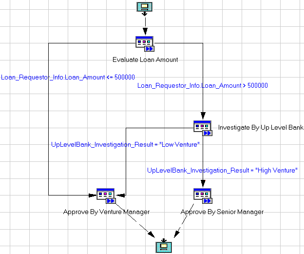

For the block involved in the root process - Investigate Loan Venture:
(The loan request amount does not exceed the limitation) First, evaluate the loan amount. If the amount does not exceed the limitation ($500000), go to activity "Approve By Venture Manager". The block ends if the venture manager approves the loan request or goes to "Evaluate Loan Amount" activity again.
