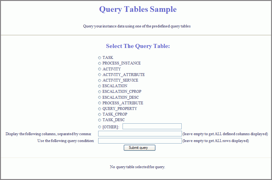

  4. The client application is displayed:

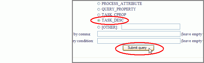

  5. Select one of the predefined query tables and press Submit query.

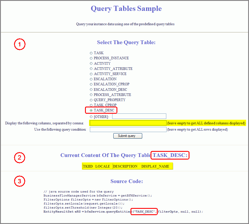

  • The client has only one main window for specifying the query and rendering both the results and the generated Java code.
  • The screen has three sections:
    1. The query specification section. Here, you can choose one of the predefined query tables (circled red) and specify constraints to restrict the number of columns and/or the number of rows that will be displayed. For example, the first input field (marked yellow) will determine the displayed columns.
    2. The content section. After pressing submit, the query result is rendered in this section; the setting specified in the query is reflected accordingly here (see red and yellow markups).
    3. The source code section. After pressing submit, for successful queries the Java source code used to launch the query is rendered in this section; the setting specified in the query is reflected accordingly here (see red markup). Any non-default column specicifation and/or query conditions will be reflected here as well (see more screenshots below).

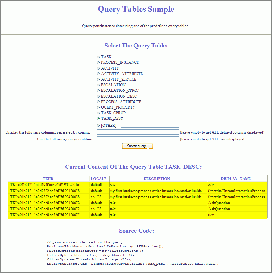

  2. Select TASK_DESC as query table, leave the text fields empty and click Submit query.
  3. Due to the created task instances, the table is now populated with data, and your screen may look similar to this one (instance data marked yellow):

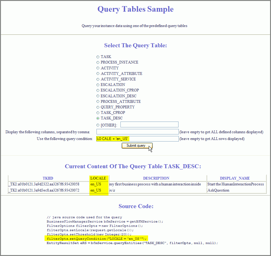

  4. Now enter a query condition that restricts the number of displayed data rows.
    For this, click the second text input field with the label Use the following query condition and enter
       LOCALE = 'en_US'
    and thereby make sure to use the case exactly as shown.
  5. The constraints entered in the query specification (marked yellow below) are now reflected in both the content section and the source code section. The screen may look similar to this one:
    Feel free to try your own queries and even to enforce error situations intentionally by entering invalid columns or query conditions.

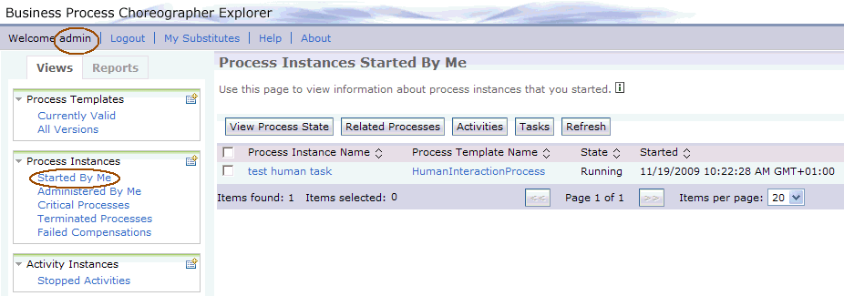

    Note: In the column STATE, the raw integer value from the database is shown. In contrast, the BPC Explorer translates the raw values from the raw value (for example, 2) into the corresponding symbolic value (for example, Running). The mapping from the raw values to the symbolic values can be found in the documentation PROCESS_INSTANCE view, TASK view, etc. in the Information Center.
    For comparison, the corresponding BPC Explorer view looks like this:
