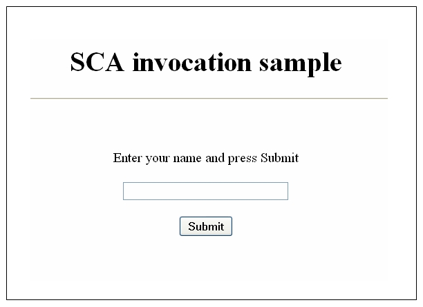

  4. The client application is displayed:

  1. Switch to the client application.
  2. In the input field, enter a value of type string.
  3. Click Submit.

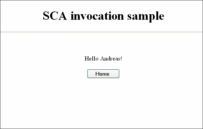

  4. The output page is displayed:

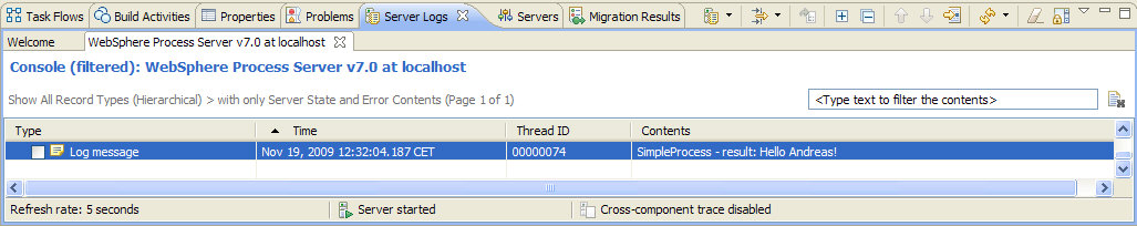

Server log
Inspect the server log of your WebSphere Process Server. The simple process prints statements similar to the following to the server log:
