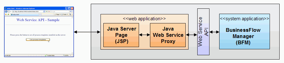

The Web application in this sample is implemented as Java code (Java Server Page). It accesses the Web service interface through a Java proxy which renders the Web service operations as Java interface. Figure 1 outlines the structure of the sample.
Figure 1: Sample application

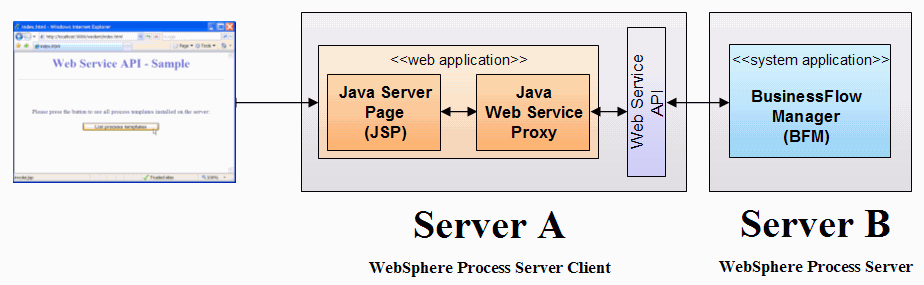

It is possible to run the client application and the Business Flow Manager on different servers. An example configuration consisting of a WebSphere Process Server Client running on WebSphere (Server A) and a WebSphere Process Server (Server B) is shown in figure 2.
Figure 2: Multi-server scenario
Note that in this scenario single sign-on must be established between server A and server B, to make sure that the LTPA token created by server A is accepted as well by server B.
