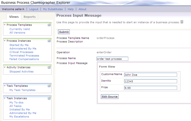

To start the order process, follow these steps:
  1. Switch to the BPC Explorer.

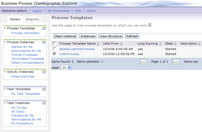

  2. Log in with user ID sellerA. Be sure to enter the user ID in mixed case exactly as shown.
  3. In the Process Templates section, click Currently Valid.
  4. The Currently Valid Process Templates view is displayed:
  5. Select orderProcess, then click Start Instance.
  6. The Process Input Message view opens:
  7. Optionally, enter a Process Name.
  8. In the CustomerName Field, enter a value of type string.
  9. In the ItemNo field, enter an integer value.
  10. In the Prize field, enter a float value.
  11. Click Submit.
After some elapsed time, you will find output similar to the output below in the log file.

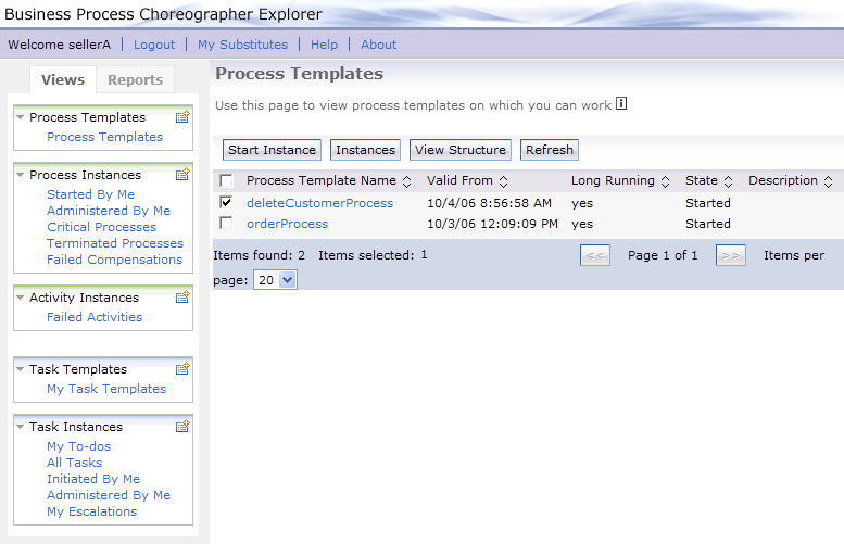

  2. Make sure you are still logged in with user ID sellerA (case sensitive).
    Hint: You can see the currently logged in user ID in the upper left corner next to "Welcome".

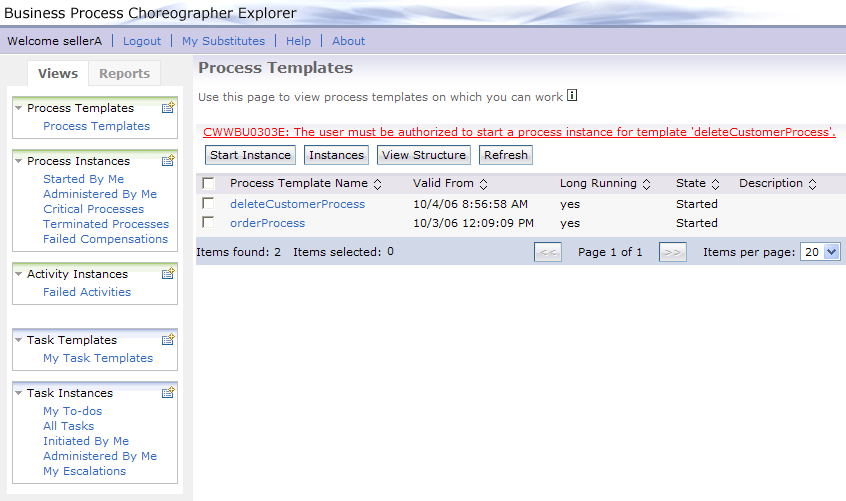

  5. Select deleteCustomerProcess, then click Start Instance.
  6. An exception message is displayed.
    In addition, this error message is added to the log file.

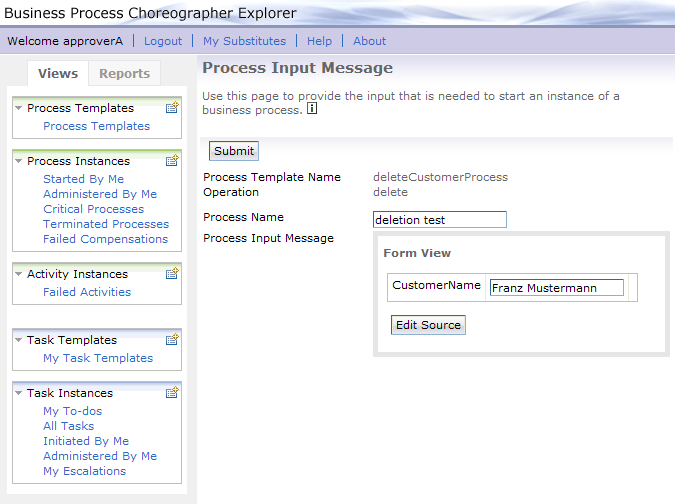

Start the Customer Deletion process with sufficient privileges
To start the customer deletion process, follow these steps:

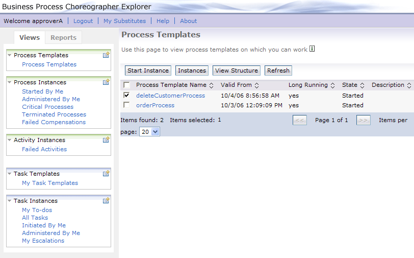

  2. Log out the previous user (sellerA) and log in with user ID approverA. Be sure to enter the user ID in mixed case exactly as shown.
  3. In the Process Templates Section, click Currently Valid.
  6. The Process Input Message View opens:
  9. Click Submit.

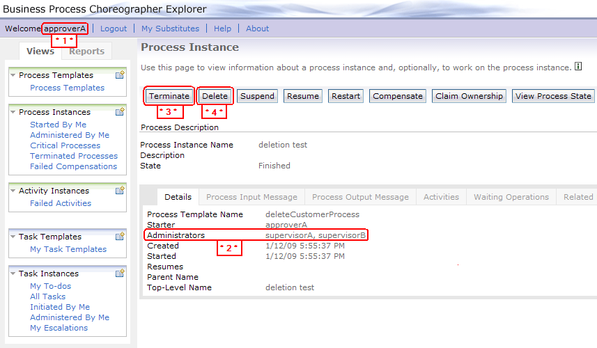

To see the list of administrators for this process, follow these steps:
  2. Make sure you are still logged in with user ID approverA (case sensitive).

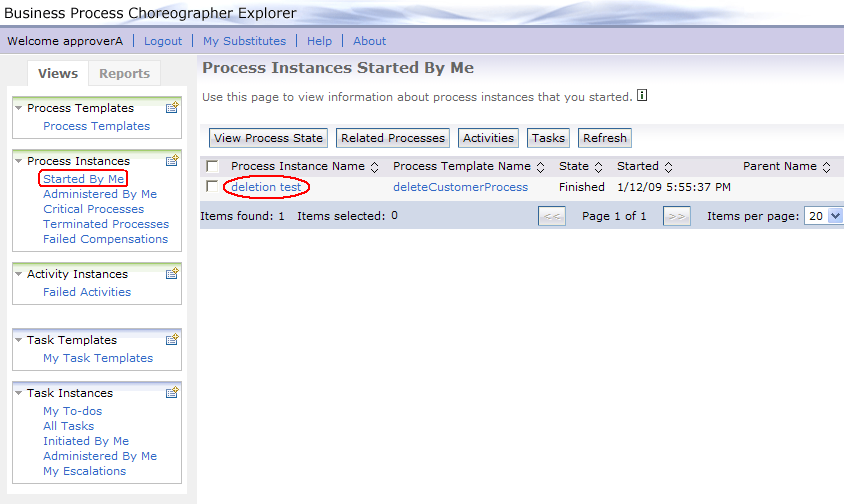

  3. In the Process Instances section, click Started By Me.
  4. The view Process Instances Started By Me is displayed:
  5. Click on the process instance of the template deleteCustomerProcess to see the details for this process instance.
  6. The Process Instance view opens. Note that you are logged in as approverA [* 1 *], but the list of administrators [*2*] does not contain that userid:
  7. Try some administrative operations; for example, if the process instance is in state Running, administrators may want to issue Terminate [*3*], and if the process instance is in state Terminated or Finished, administrators may want to issue Delete [*4*].

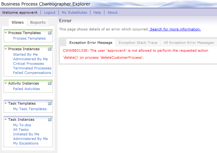

  8. Since you are not logged in as an administrator, an exception message like this is displayed:
    In addition, in the log file you will find output similar to the output below:
    [1/12/09 18:11:24:713 CET] 000002a5 BpelEngine   I  CWWBE0133E: The user 'approverA' is not allowed to perform the requested action 'delete()' on process 'deleteCustomerProcess'.

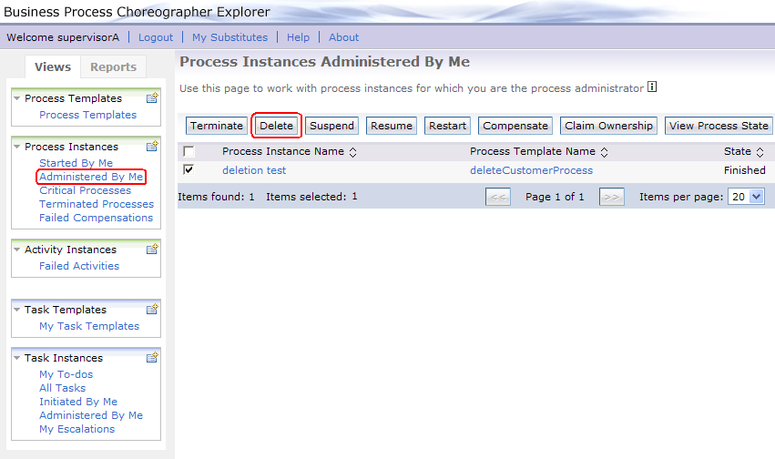

Do administrative operations on the Delete Customer process with appropriate privileges
In this section we repeat the administrative operations, now with sufficient privileges. For this, we log in as supervisorA, who is a member of the group supervisors, which is specified as the set of administrators for this process.
Follow these steps:
  2. Log out the previous user (approverA) and log in with user ID supervisorA. Be sure to enter the user ID in mixed case exactly as shown.
  3. In the Process Instances Section, click Administered By Me.
  4. The view Process Instances Administered By Me is displayed where you should find the process instance either in Running or in Finished state:
  5. Check the checkbox next to the process instance name.
  6. If the process instance is in state Running, wait for some time and then press Refresh. Repeat this step until the process instance is in state Finished. Alternatively, you may try the Terminate operation instead of waiting.
  7. Use the Delete operation.
  8. Press Refresh and verify that this process instance has disappeared.
