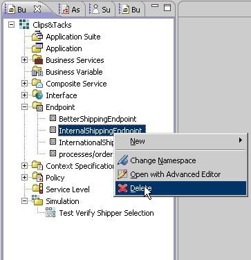

- Switch back to the Business Services perspective in WebSphere® Integration Developer. Remove the InternalShipping endpoint by right-clicking InternalShippingEndpoint and selecting Delete.

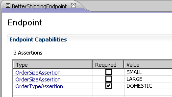

- Modify the BetterShipping endpoint.
- Double-click BetterShippingEndpoint to open its editor. Select the Assertions tab and click Add, which is in the upper-right corner of the Endpoint Capabilities table.
- Expand the Interoperability folder, expand the Content Based Assertion folder, and then select OrderSizeAssertion and click OK.
- In the window that opens, select SMALL for the order size, and then click OK.You have created an instance of this assertion type and associated it with this endpoint. There is now a row for this assertion in the table.
- In the Capabilities table, clear the check box in the Required column for OrderSizeAssertion with a value that equals LARGE. Save your work.
- Verify that you have three rows in the Endpoint Capabilities assertions table and close the editor.
