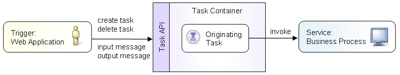

An originating task is a server-side component representing human interaction with a machine supported service, which can be accessed through a WSDL defined interface. The originating task offers functions to create and start the service. When starting the service, input data can be directed to the service. Upon service completion, the result of the service execution can be received. An originating task supports the definition of access rights with respect to service creation and start. The following image illustrates the originating task as the interaction component between a human and a machine supported service:
The person interacts with the originating task through a user interface. This user interface is usually embedded in an application, and it presents the input and output messages to the originator.

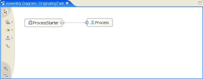

The components of the OriginatingTaskApp are shown in the following assembly diagram:

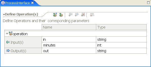

The Originating Task "ProcessStarter" invokes the business process "Process". Both use the same interface "ProcessInterface":

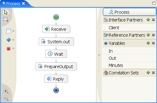

When an input message arrives, the business process prints a message to System.out.log, then it waits for the specified number of minutes. Finally the process computes the output message and sends the reply message back to the invoker:
In this example, the authorization scheme is such that "everybody" can create and start tasks and, indirectly, process instances.
