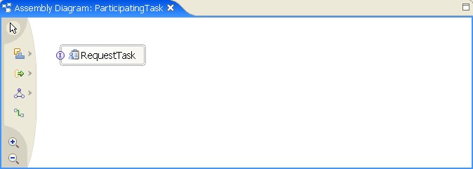

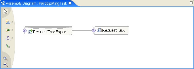

SCA export
You can make a participating task available outside the SCA component by exporting the interface. You can choose different bindings like SCA or SOAP. To export the interface, add an export to your SCA module. The preferred interaction style of the participating task is asynchronous. The following diagram shows how the participating task is exported with a SCA binding:
SCA component

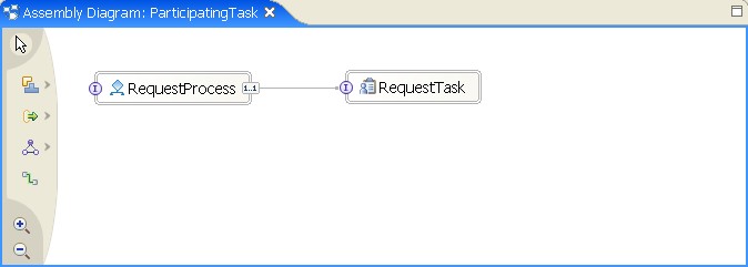

If you want to invoke the participating task from components inside your SCA module, you can add a wire from these components to the participating task component. Note that the participating task has a preferred interaction style of asynchronous and a join transaction qualifier of false. BPEL processes that invoke participating tasks should be defined as long-running processes. Additionally the asynchronous nature of the participating tasks should be considered, when the BPEL process is modeled. The following diagram shows the wiring from a BPEL process to the participating task.
The ParticipatingTaskApp in the download section of this sample contains a simple BPEL process that calls the participating task.

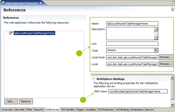

Prepare your web application
Add a reference to the local session bean to the web deployment descriptor. The relevant elements of the deployment descriptor are shown in the following XML fragment:
<ejb-local-ref>
  <ejb-ref-name>ejb/LocalHumanTaskManagerHome</ejb-ref-name>
  <ejb-ref-type>Session</ejb-ref-type>
  <local-home>com.ibm.task.api.LocalHumanTaskManagerHome</local-home>
  <local>com.ibm.task.api.LocalHumanTaskManager</local>
</ejb-local-ref>
To add a EJB reference binding, complete the following steps:
  1. Switch to the deployment descriptor editor of your web application.
  2. Click the References tab.
  3. In the JNDI name field, enter the reference binding.
  4. The following screenshot shows the reference binding of the web deployment descriptor in WebSphere Integration Developer:
