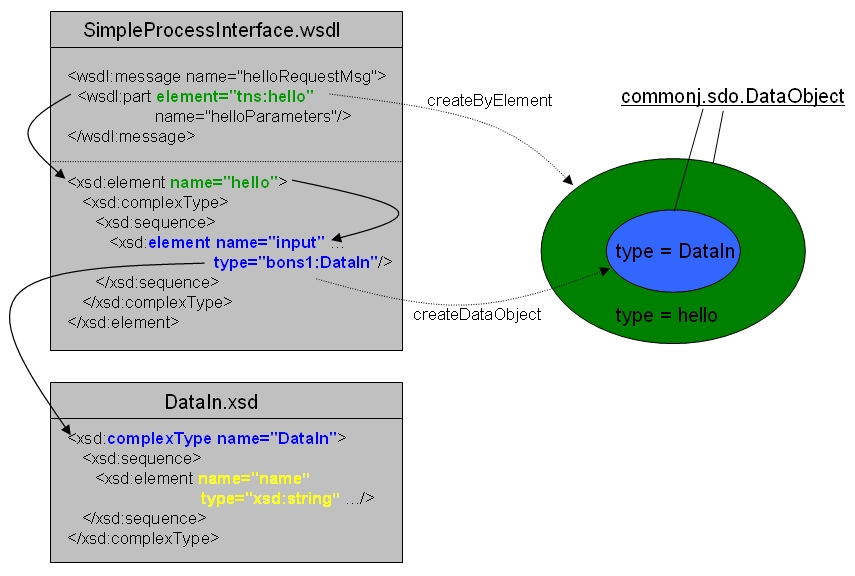

The business process of this sample uses two business objects: DataIn for input data, and DataOut for output data. Before calling the process, the application has to define the input business object, after the call, the output business object is returned to the application.
When you take a look at the definition of the interface SimpleProcessInterface.wsdl and the business Object DataIn.xsd, you will recognize that DataIn and DataOut are wrapped in a message elements, which are in turn business objects, too. You have to consider this structure, when you create business objects for your process.
The following picture shows the structure of the business objects and outlines how you can create the corresponding commonj.sdo.DataObjects:
Since this sample uses a JSP to invoke the business process, the first step is to create the input business object as commonj.sdo.DataObject. The type of that business object is the type of the input message as defined by the the process interface. So, two commonj.sdo.DataObjects have to be created: an outer business object of type XSD element hello, and an inner one of XSD type DataIn.
The following Java code snippets show how you can create the input business object .
