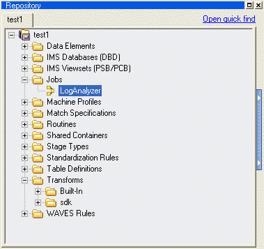

  2. In WebSphere DataStage and QualityStage Designer, select Import > DataStage Components.
  3. Enter the path to the LogAnalyzer.dsx file and click OK. The imported job appears in the Repository tree.
  4. Double click the LogAnalyzer job.The job design is opened.

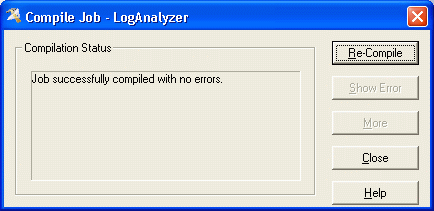

  7. From the menu, select File > Compile. The job should compile without any errors.
  8. Click Close.

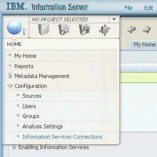

  1. Open the IBM Information Server console.
  2. From the HOME pillar (blue sphere on the top left), expand the Configuration section and select Information Services Connections as shown below.

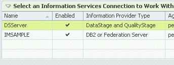

  3. Expand the Select an Information Services Connection to Work With section.
  4. Verify that the DSServer connection is enabled (has a check mark in the Enabled column).

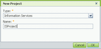

  2. Expand the Projects section and click New Project.
  3. Select Information Services for type and enter a project name, for example, ISProject.

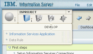

  1. From the DEVELOP pillar, select Information Services Application.
  2. Expand the Select Information Services Application to Work With section and select New from the task list on the right.

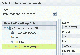

  11. Click Select to select an information provider.
  12. Select the DataStage and QualityStage type. Your DSServer provider appears in the Select a DataStage Job view.
  13. Expand your DataStage project and select the LogAnalyzer job.
  14. Click OK.

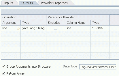

  16. Select the Outputs tab and check both Group Arguments into Structure and Return Array.
  17. Click Save Applications.

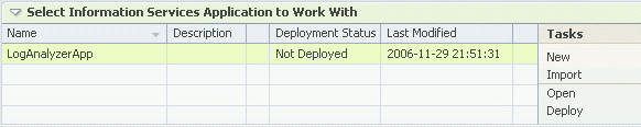

  22. Expand the Select Information Services Application to Work With section, select LogAnalyzerApp, and click Deploy.
  23. Click Deploy again to deploy the application. Wait until the progress bar on the bottom disappears. The application deployment status changes to Deployed.

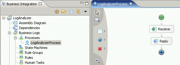

  5. Right-click the new LogAnalyzer module and select New > Business Process.
  6. Enter the process name LogAnalyzerProcess and click Finish.

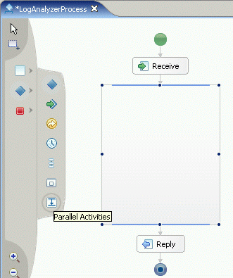

  7. Click the white area of the process editor and change the checkbox settings in the properties view Details tab as shown below.

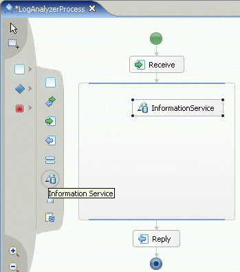

  8. From the palette, select Parallel Activities and add it to the process as shown below.
Add the Information Service activity
  1. From the palette, select Information Service and add it to the process as shown below.

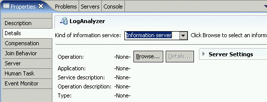

  2. Select the information service activity, in the properties view select the Description tab, and enter a display name, for example, LogAnalyzer.
  3. In the properties view select the Details tab.
  4. Click Browse.

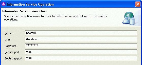

  5. In the Information Service Operation window, enter the Information Server connect information, and click Next.

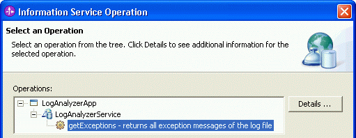

  6. Now the window displays the applications and services deployed on the Information Server. Expand the LogAnalyzerApp application, the LogAnalyzerService service, and select the getExceptions operation.

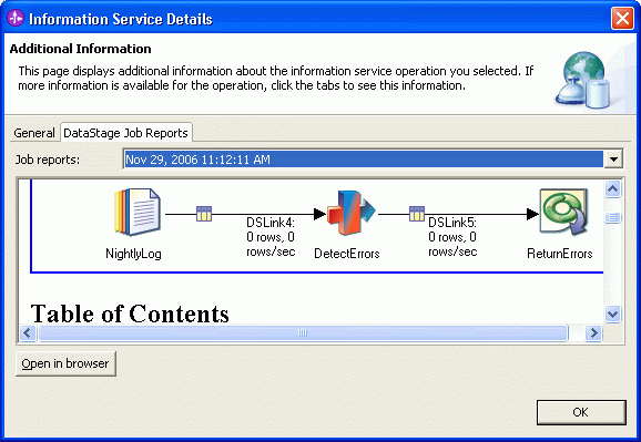

  7. Click the Details button to get additional information about the service, the operation, and the underlying DataStage job.
  8. Click OK and then Next.

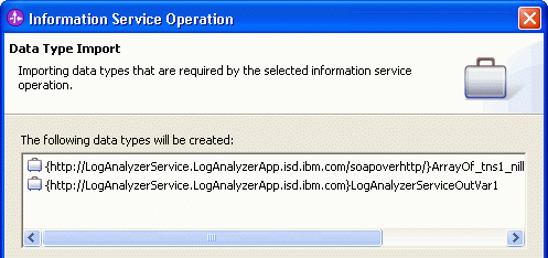

  9. The Business Object Import window, lists the business objects that will be imported.
  10. Click Finish.

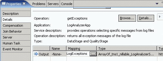

  14. In the process editor, create a new process variable named LogExceptions (by pressing in the Variables section) and set the variable Data Type to ArrayOf_tns1_nillable_LogAnalyzerServiceOutVar1.
  15. Select the LogAnalyzer activity and map the Output to the LogExceptions Variable (by selecting the Mapping cell of the Output row and clicking the button that appears to select the variable).

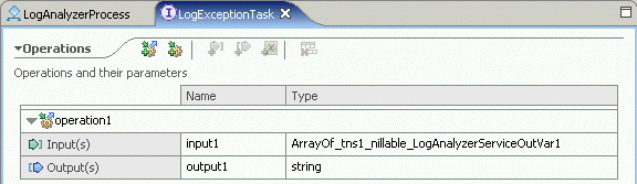

  1. In the Business Integration view, right-click Interfaces and select New > Interface. This will open the Interface editor.
  2. Enter an interface name, for example, LogExceptionTask and click Finish.
  3. Click the Add Request Response Operation button (), click the string input1 and select ArrayOf_tns1_nillable_LogAnalyzerServiceOutVar1 from the list of available types.
    Then press Ctrl+s to save your changes or click Save on the toolbar.

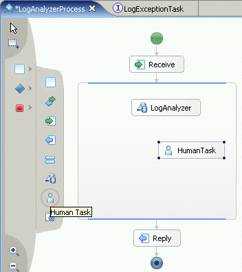

  4. From the palette, select Human Task and add it to the process as shown below.
  5. Select the Human Task activity, in the properties view select the Description tab, and enter a display name, for example, handleExceptions.

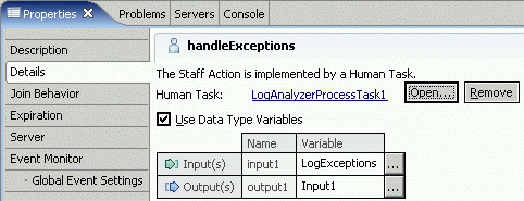

  6. Select the Details tab and click New.
  7. In the Interface Selection window, select the LogExceptionTask interface and click OK.
  8. In the Select Operation window, select operation1 and click OK.
  9. Leave the opened task editor untouched and switch back to your process.
  10. Back in the Details tab of the task, map the input to the LogExceptions variable and the output to the Input1 variable as shown below.

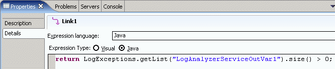

  11. Right-click the LogAnalyzer activity, select Add Link and click the handleExceptions (human task) activity.
  12. Click the new link, set the expression language to Java and the expression type to Java.
  13. Enter this line in the expression field:
    return LogExceptions.getList( "LogAnalyzerServiceOutVar1" ).size() > 0;
