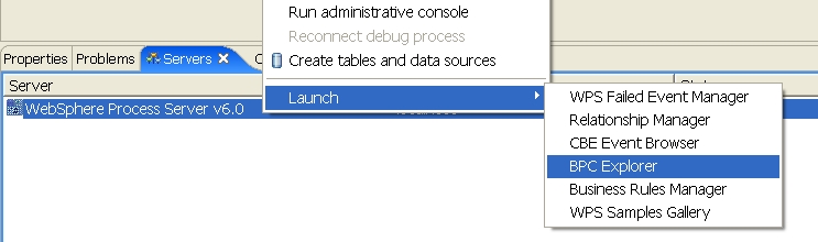

To start the BPC Explorer in the integrated test environment of your WebSphere Integration Developer, follow these steps:
  1. In WebSphere Integration Developer, switch to the Servers view.
  2. In the table, right-click WebSphere Process Server v6.0.
  3. From the pop-up menu, select Launch > BPC Explorer.
  4. The BPC Explorer opens:

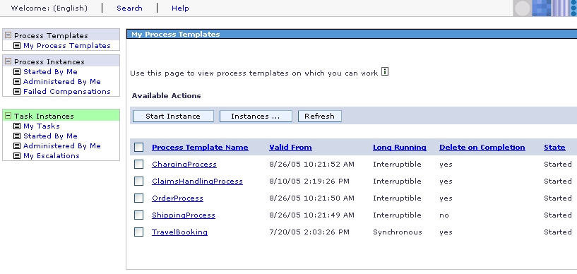

  1. Switch to the BPC Explorer
  2. In the Process Templates Section, click My Process Templates.
  3. The My Process Templates view is displayed:
  4. Select OrderProcess, then click Start Instance.

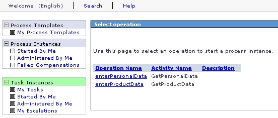

  5. The Select operation view opens:

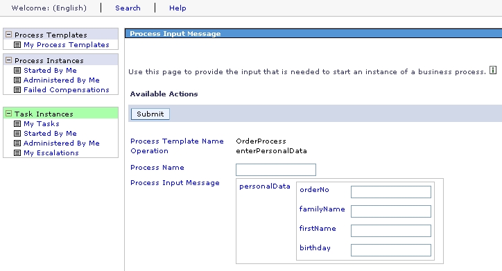

  6. Click enterPersonalData.
  7. The Process Input Message view opens:
  8. Optionally, enter a Process Name.
  9. In the orderNo field, enter a value of type string. This value is required again later, when you send product data to the business process.
  10. In the familyName field, enter a value of type string.
  11. In the firstName field, enter a value of type string.
  12. In the birthday field, enter a value of type string.
  13. Click Submit.
If you enter the values that are listed in the following table, the process generates the described results:

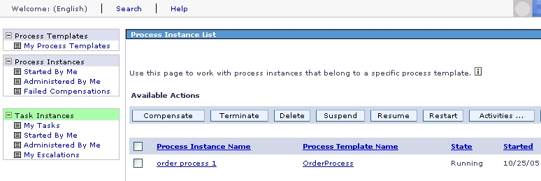

  1. In the BPC Explorer, switch to the My Process Templates view.

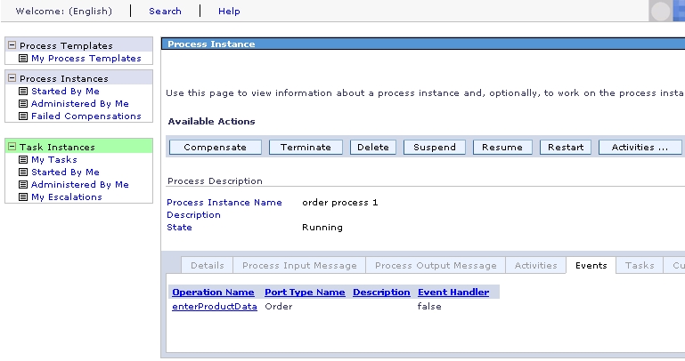

  2. Select OrderProcess, then click Instances.
  3. The Process Instance List is displayed:

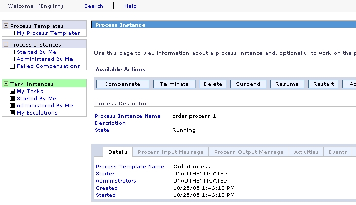

  4. Click the process instance name order process 1.
  5. The Process Instance view is displayed:
  6. Click the Process Output Message tab.
  7. Click the Events tab.
  8. A list with all messages that can be sent to the process is displayed:

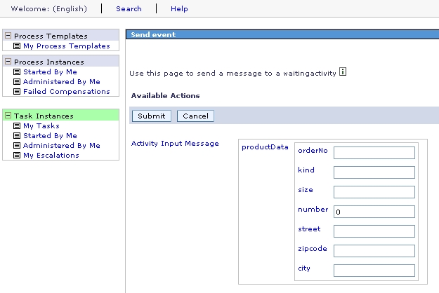

  9. Click enterProductData.
  10. The Send event view is displayed:
  11. In the orderNo field, enter a value of type string. Use the same value as you have entered for orderNo in the personal data.
  12. In the kind field, enter a value of type string.
  13. Leave the size field blank. The process calculates this value based on the number.
  14. In the number field, enter a numeric value.
  15. In the street field, enter a value of type string.
  16. In the zipcode field, enter a value of type string.
  17. In the city field, enter a value of type string.
  18. Click Submit.

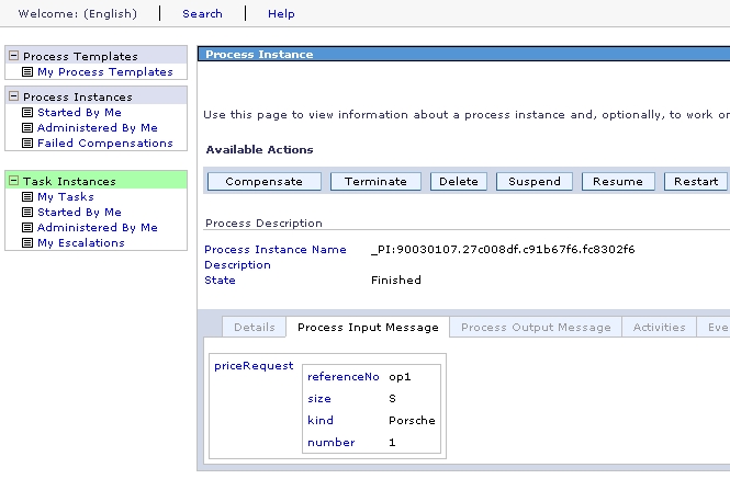

To display the process' input and output messages, follow these steps:

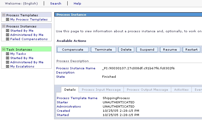

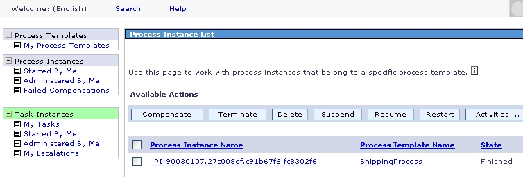

  2. Select ShippingProcess, then click Instances.
  3. The process instance list is displayed:
  4. Click the process instance name.
  6. Click the Process Input Message tab.
  7. The process input message is displayed:

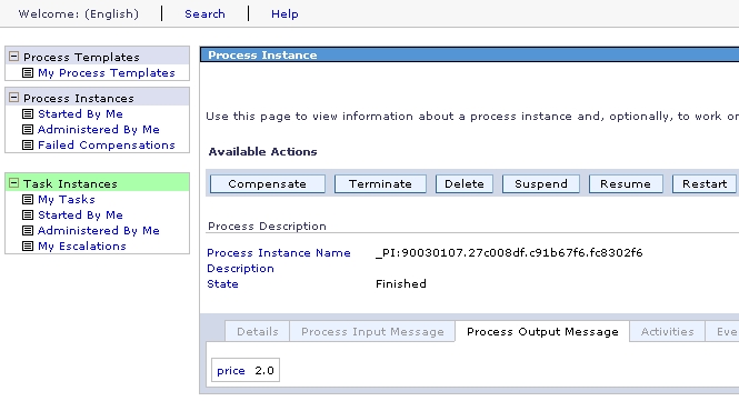

  8. Click the Process Input Message tab.
  9. The process output message is displayed:
  4. Select all process instances with a state of Finished or Failed.
