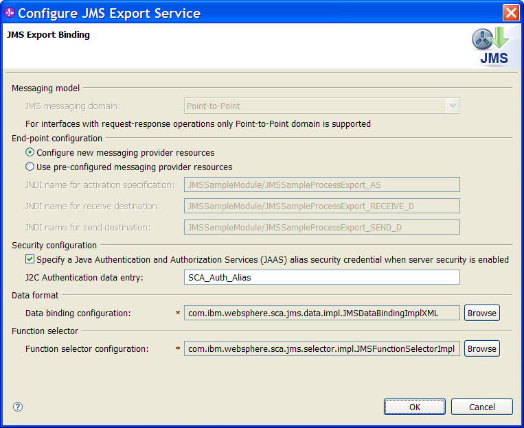

  3. From the pop-up menu, select Generate Export > Messaging Binding > JMS Binding.
  4. The Configure JMS Export Service window opens:

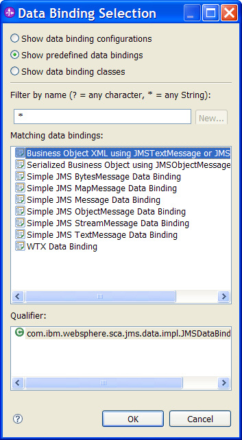

  5. Next to the Data binding configuration field, click Browse. The Data Binding Selection window opens:
  6. Select Show predefined data bindings.
  7. In the Matching data bindings field, select Business Object XML using JMSTextMessage or JMSBytesMessage.
  8. Click OK.

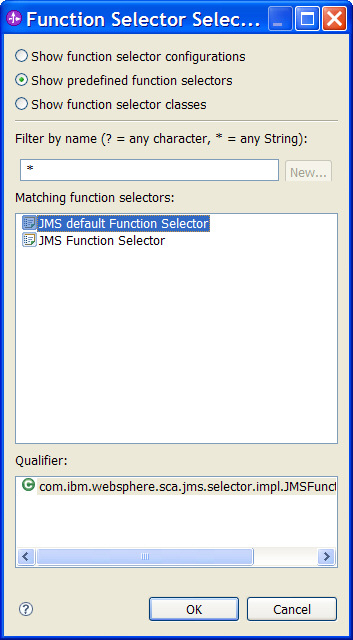

  9. Next to the Function selector configuration field, click Browse. The Function Selector Selection window opens:
  10. Select Show predefined function selectors.
  11. In the Matching function selectors field, select JMS default Function Selector.
  12. Click OK.
  13. Click OK.

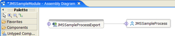

  14. The export has been added:
  15. On the toolbar, click the Save button .

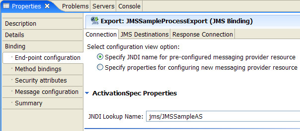

  4. Click the End-point configuration tab.
  5. Select the Specify JNDI Name for pre-configured messaging provider resource option.
  6. Under ActivationSpec Properties, enter jms/JMSSampleAS in the JNDI Lookup Name field.

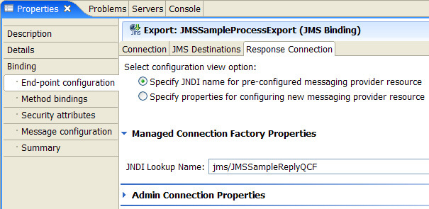

  7. Click the Response Connection tab.
  8. Select the Specify JNDI Name for pre-configured messaging provider resource option.
  9. Under Managed Connection Factory Properties, enter jms/JMSSampleReplyQCF in the JNDI Lookup Name field.

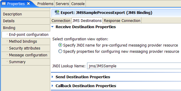

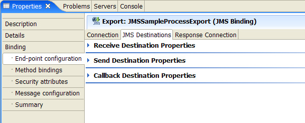

  10. Click the JMS Destinations tab.
  11. Expand Receive Destination Properties.
  12. Select the Specify JNDI Name for pre-configured messaging provider resource option.
  13. In the JNDI Lookup Name field, enter jms/JMSSample.
  14. Expand Send Destination Properties.
  15. Select the Specify JNDI Name for pre-configured messaging provider resource option.
  16. In the JNDI Lookup Name field, enter jms/JMSSampleReply.
  17. Expand Callback Destination Properties.
  18. Select the Specify JNDI Name for pre-configured messaging provider resource option.
  19. In the JNDI Lookup Name field, enter jms/JMSSampleCorrelation.
