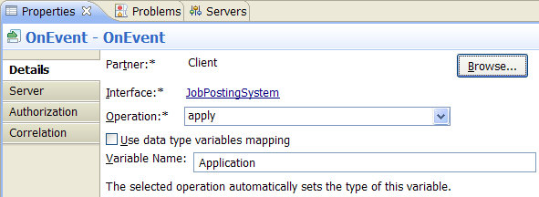

Defining 'on event' event handlers
To add an 'on event' event handler to a scope, perform the following steps:
  1. In the business process editor, click the scope, then click the Add event handler button .
  2. The event handler is added:
  3. In the event handler, click OnEvent.
  4. Go to the Properties view and select the Details tab.
  5. To select an interface partner, click Browse. The Select a Partner window opens.
  6. Select the matching partner, then click OK. The window closes.
  7. Select the appropriate operation in the field next to Operation.
  8. Deselect the option Use data type variables mapping.
  9. In the Variable Name field, enter a name for the variable. The variable type will be set automatically to the type of the WSDL message.
  10. On the toolbar, click the Save button .

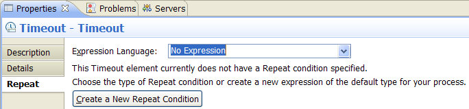

Defining 'timeout' event handlers
To add a 'timeout' event handler to a scope, perform the following steps:
  1. In the business process editor, expand the event handler in case it is collapsed. If no event handler was defined, create an event handler.
  2. Right-click the event handler.
  3. From the pop-up menu, select Add a Timeout Element.
  4. The on alarm event handler is added:
  5. In the event handler, click Timeout.
  6. Go to the Properties view and select the Details tab.
  7. Select an Expression language.
  8. Specify the appropriate expression.
    Note: For more detailed information about expressions, refer to the information center.
  9. On the toolbar, click the Save button .
To add a repeating timeout to your on alarm event handler, perform the following steps:
  1. In the business process editor, click Timeout.
  2. Go to the Properties view and select the Repeat tab.
  3. Select an Expression language.
  4. Specify the appropriate expression.
  5. On the toolbar, click the Save button .
