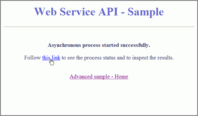

  4. The start page of the Advanced sample is displayed. Enter the fields with any values of your choice and press Submit data:
  5. An indication is given whether the business process was started successfully. If the start did not succeed ("No response available") then double-check that the WSApiModuleApp is deployed and started successfully on your server, and then look for problems visible in the server logs.
    After a successful start of the process, the screen looks like this:
  6. Follow the first hyperlink on the screen; this link uses a parameterized URL similar to http://localhost:9080/wsclient/viewprocess.jsp?PIID=_PI:90030119.ec15872f.b61b67f6.dc830215 which navigates to a status page for this particular process instance. For some seconds, the status will be STATE_RUNNING as the underlying BPEL process uses a sleep operation to delay the execution for some time (sleep time 10 seconds):
