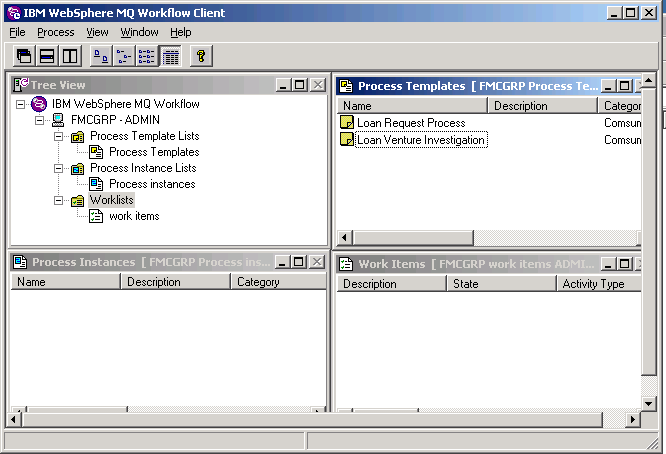

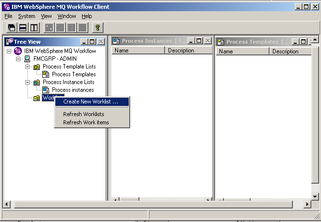

Process Templates.The new process template appears in the navigation panel as shown below:

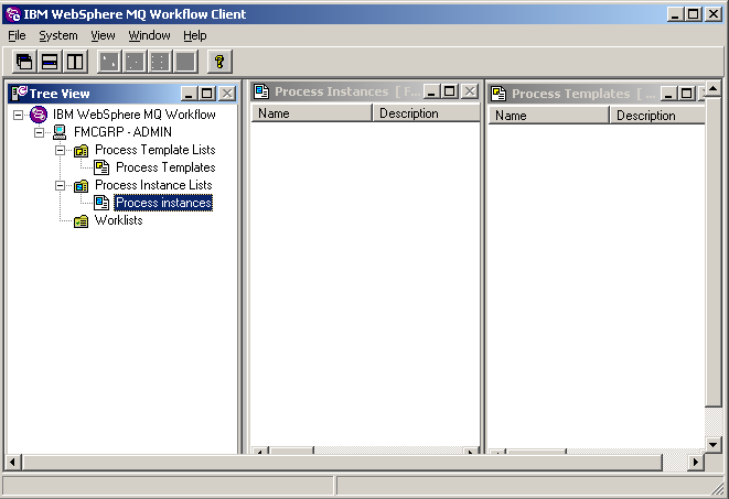

Process instances.The new process instances list appears in the navigation panel as shown below:
work items.The new work items page appears in the navigation panel as shown below:

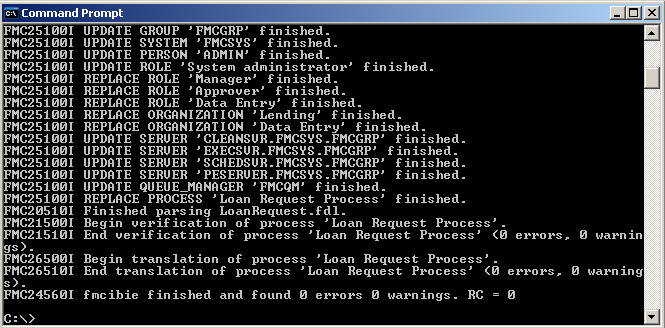

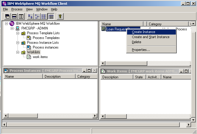

fmcibie -u ADMIN -p password -o -t -i LoanRequest.fdl, and press Enter.After the FDL file is imported, you should see a new row in the Process Template Lists as shown below:
The following image shows the new instance on the Process Instance List.
The following image shows the new item on the worklist.

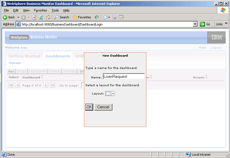

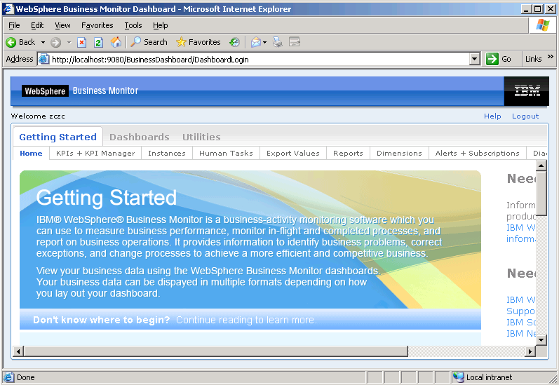

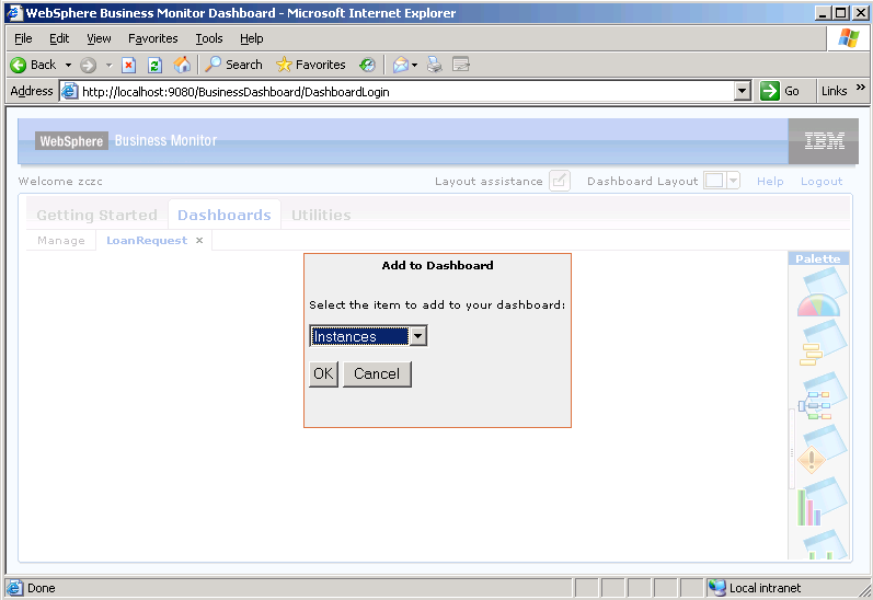

In this section, you will build a dashboard on a Web-based dashboard to display the monitor result.
LoanRequest and then click OK.A new frame is added to the dashboard as shown below.

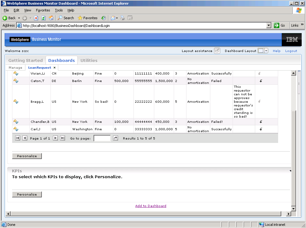

The image below shows an example instance view.
A new frame is added to the dashboard under the instances view as shown below.

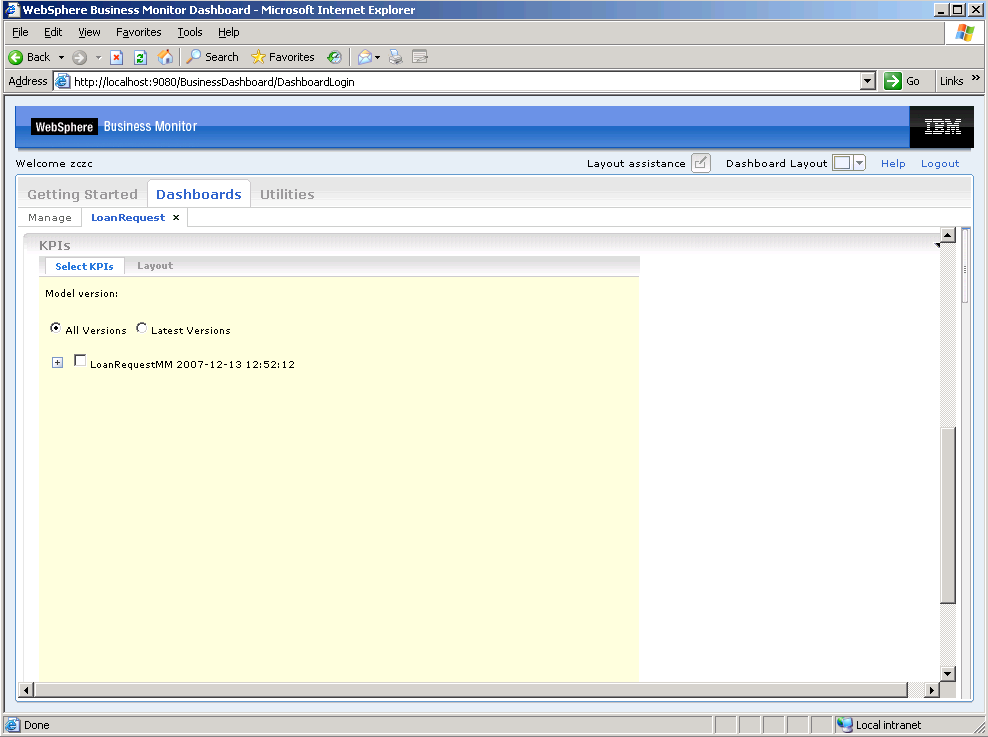

The image below shows an example KPIs view.
A new frame is added to the dashboard under the KPI view as shown below.

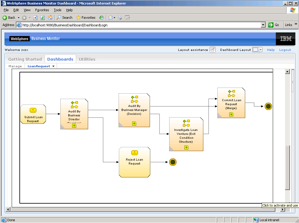

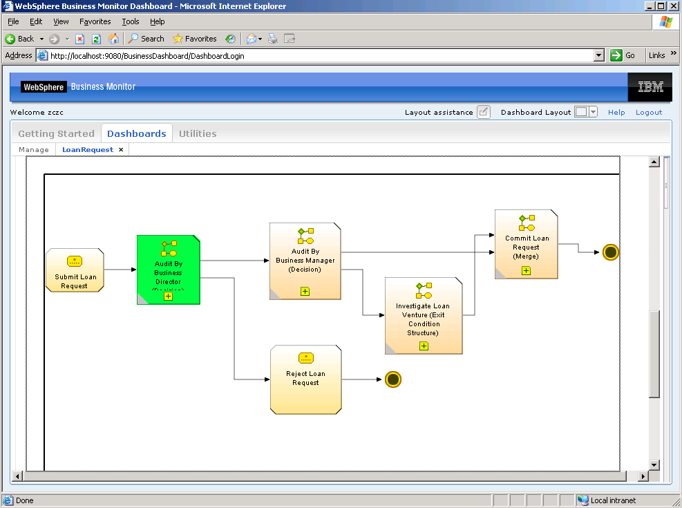

The image below is an example of a Diagram view.
A new frame is added to the dashboard.

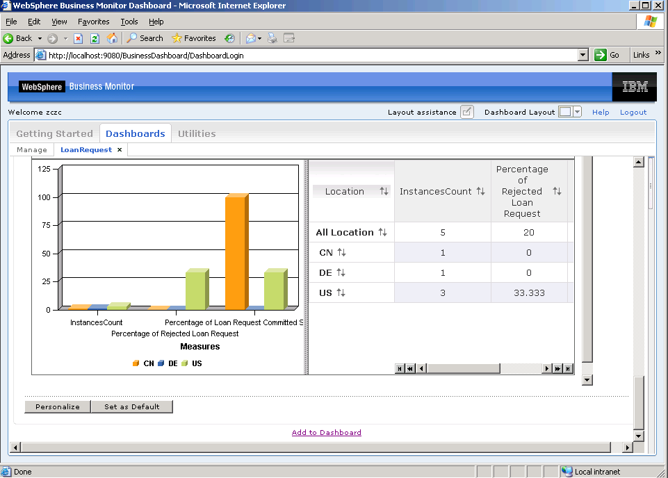

The image below shows an example Dimensions view.
A new frame is added to the dashboard under the Dimensions view as shown below.

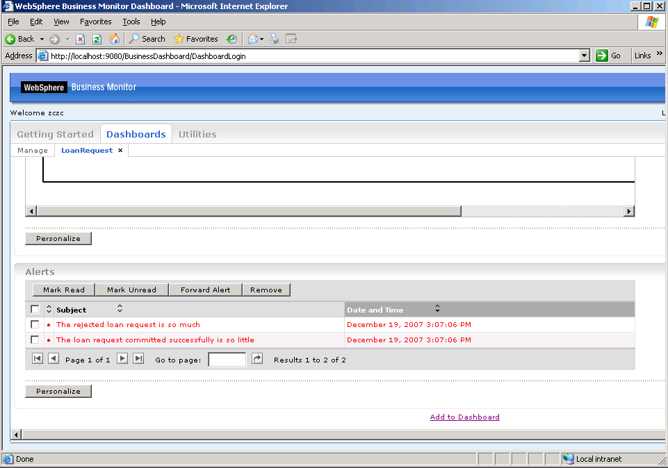

When an alert condition occurs, an alert is displayed.
