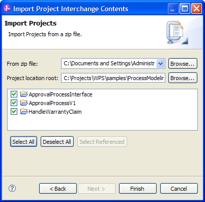

  1. Download the VersioningPrepare.zip file and save it to a temporary directory.
  2. In WebSphere® Integration Developer, click File > Import. The Import window opens.
  3. Select Other > Project Interchange.
  4. Click Next. The Import Project Interchange Contents window opens.
  5. Click Browse next to From zip file.
  6. Browse to the temporary directory. Select VersioningPrepare.zip, and click Open.
  7. Verify your Project location root.
  8. Click Select All.
  9. Click Finish.

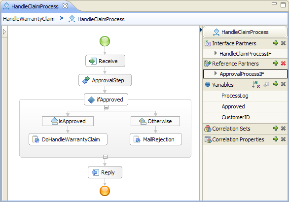

  1. In the HandleWarrentyClaim project, select the business process HandleClaimProcess.
  2. Right-click and open the business process editor.
  3. Click on the Reference Partner ApprovalProcessIF.
  4. Switch to the Properties view.
  5. Select the Description tab.
  6. In the field Process Template enter ApprovalProcess.
  7. On the toolbar click the Save button to save this change and close the business process editor.

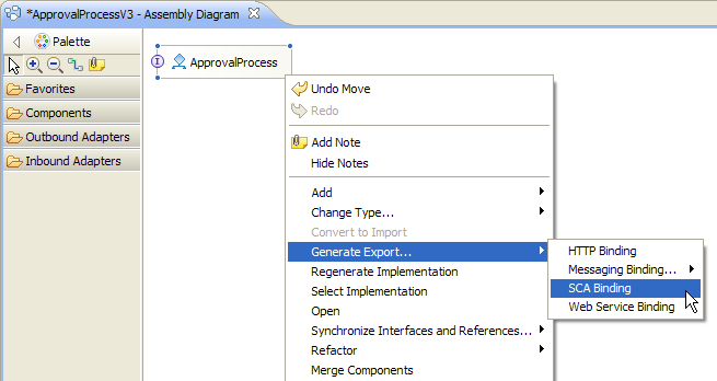

  3. In the Assembly Diagram, right-click ApprovalProcess and select Generate Export > SCA Binding.

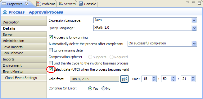

Next, we change the Valid From settings that are still identical to the version 1 values. Without this change, this would create a conflict when trying to install both process versions on the server. Follow these steps:
  1. Expand ApprovalProcessV2 > Integration Logic > Processes.
  2. Double-click the ApprovalProcess business process to open the business process editor.
  3. Switch to the Properties view and proceed to the Details tab for the process. This displays the Valid From settings.
  4. Uncheck the checkbox with label Select Date (UTC). The Valid From settings are grayed out.
  5. Check the same checkbox again. This refreshes the Valid From settings with the actual time, translated to the UTC format.
  6. Note: You can set the Valid From settings explicitly to define the point in time when the runtime system should start using this process template. Keep in mind that the process template may be invisible before that point in time is reached.

  4. Right-click ApprovalProcess and select Generate Export > SCA Binding.

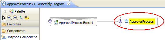

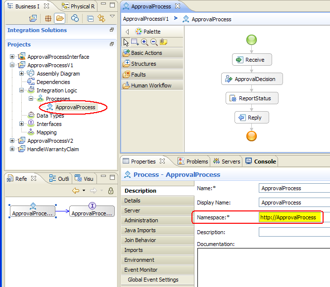

First, we find out the process component name of the version 1 process. As the version 1 exists in the workspace, follow these steps:
  1. Right-click ApprovalProcessV1 > Assembly Diagram and select Open With > Assembly Editor.
  2. Identify the process component name, circled red in the following screenshot:
  3. The process component name in this sample is ApprovalProcess, record it as you will need it later on.
  4. Close the assembly editor.
  5. Note: By default, the process component name is identical to the process name. However, for the case that these two names differ, it is important to do this lookup in the assembly editor as described here.
Next, we find out the namespace of the version 1 process. Follow these steps:
  1. Expand ApprovalProcessV1 > Integration Logic > Processes.
  3. Switch to the Properties view.
  4. The target namespace is visible in the Description tab. In this sample, it is http://ApprovalProcess, record it as you will need it later on.
  5. Close the business process editor.

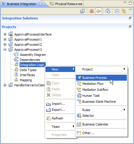

Next, we create the new version of the business process. Follow these steps:
  1. In the Business Integration view, expand ApprovalProcessV3.
  2. Right-click Integration Logic > New > Business Process.

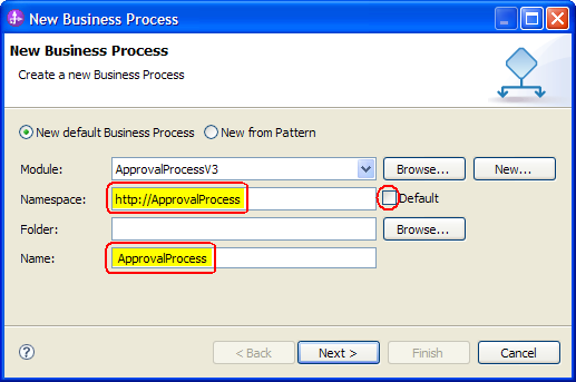

  3. In the New Business Process dialog, specify ApprovalProcess as name. By default, this will imply the appropriate process component name in the assembly editor later.
  4. For specifying the Namespace, uncheck the Default checkbox and change the value to http://ApprovalProcess.
  5. Note: Process component name and namespace must be identical to the values used for the version 1 definition, which is why we looked up these values earlier.
  6. Click Next.

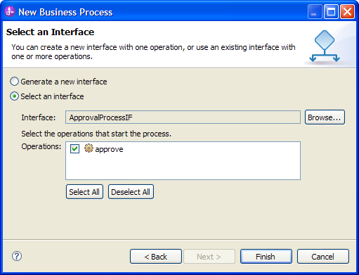

  9. In the Select an Interface dialog, choose Select an interface.
  10. Use Browse to select the ApprovalProcessIF interface and the approve operation.
  11. Click Finish. The business process editor opens.
