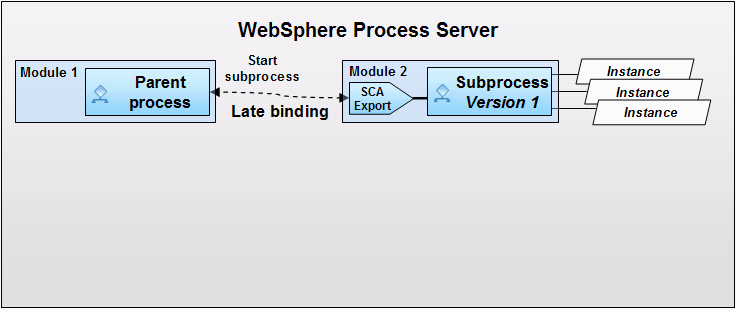

Initially, the structure of the involved modules looks like this:
| Figure 1: Module structure for a scenario enabled for evolving versions of the subprocess |
Note: Even for the first version you need to use the late binding mechanism when calling the subprocess to be prepared that a new version of the subprocess can be called without any change in the parent process.

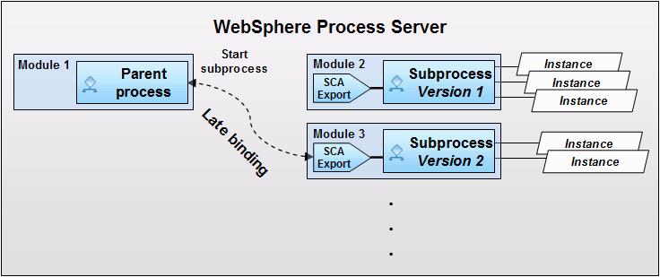

Next, a new version of the subprocess to be used from now on is installed on the server. This does not overwrite the existing version of the subprocess; this rather provides an additional version that will coexist with the older versions. As soon as the Valid From date specified for the new process version is reached, all newly created instances are created based on this new process version - version 2. However already existing instances based on version 1 will continue to run according to version 1 of the business process.
The new structure of the involved modules looks like this:
| Figure 2: Module structure after installing a new version of the subprocess |

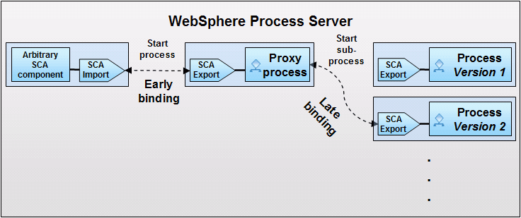

The late binding mechanism as described in this sample is only supported between processes; in other words, to use the late binding mechanism it is required that both the invoking component and the invoked component are BPEL processes. All other SCA components need their references to be wired in the assembly editor and hence are subject to early-binding. However, the late binding mechanism can be extended to other SCA components that are supposed always to call the most recent version of a process. This is done by adding a proxy process between the calling SCA component and the evolving process. The SCA component is then wired to the proxy process (early binding) and the proxy process calls the evolving process using the late binding mechanism.
The structure of the components including the proxy process is shown in figure 6.
| Figure 6: Implementing late binding for arbitrary SCA components by using a proxy process |

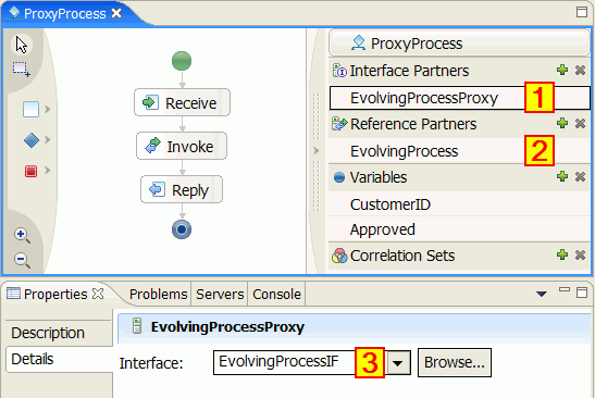

The implementation of the proxy process is simple:
It just contains the activities that represent the initiating operation of the process,
that is a receive activity and an reply activity if the operation is a request-response operation,
and an invoke activity to call the evolving process using late binding.
For best performance, the proxy process should be a microflow in each of the following cases:
In all other cases, the proxy process should be a long-running process.
The details of the proxy process implementation are shown in figure 7.
| Figure 7: Proxy process implementation details |
Remarks:
in the figure.
in the figure.
in the figure; here, the interface with name EvolvingProcessIF is used.EvolvingProcessProxy and EvolvingProcess are used.
