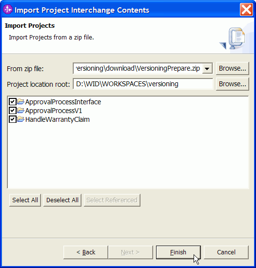

To import the module that provides the required artifacts into your workspace, follow these steps:
  1. Download the VersioningPrepare.zip file and save it to a temporary directory.
  2. In WebSphere Integration Developer, click File > Import. The Import window opens.
  3. Select Project Interchange.
  4. Click Next. The Import Project Interchange Contents window opens.
  5. Click Browse next to From zip file.
  6. Browse to the temporary directory. Select VersioningPrepare.zip, and click Open.
  7. Verify your Project location root.
  8. Click Select All.
  9. Click Finish.

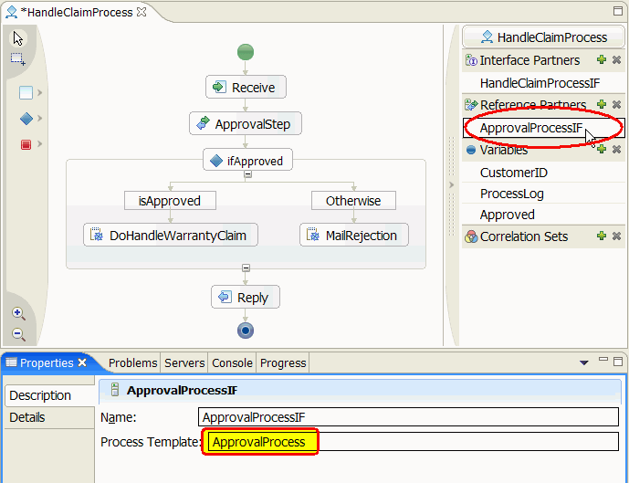

In this section, you provide the parent process with the process template name of the subprocess which will then be used for a dynamic lookup of the currently valid template at runtime.
Note that intentionally the reference partner used in the ApprovalStep is not wired to any target in the assembly editor, as the target will be dynamically selected during runtime. This causes warning CWSCA8015W to appear after the workspace has finished the build operation:
To enable the parent process for late binding, follow these steps:
  1. In the HandleWarrentyClaim project, select the business process HandleClaimProcess.
  2. Right-click and open the business process editor.
  3. Click on the Reference Partner ApprovalProcessIF.
  4. Switch to the Properties view.
  5. Select the Description tab.
  6. In the field Process Template enter ApprovalProcess.
  7. On the toolbar click the Save button to save this change and close the business process editor.

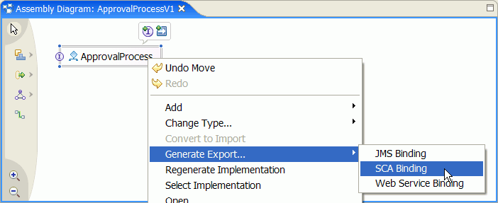

In this section, you add an SCA export to the version 1 of the subprocess that is required to call the subprocess across module boundaries.
Follow these steps:
  1. Expand the ApprovalProcessV1 project.
  2. Right-click ApprovalProcessV1 > Assembly Diagram and select Open With > Assembly Editor.
  3. In the Assembly Diagram, right-click ApprovalProcess and select Generate Export > SCA Binding.
  4. On the toolbar click the Save button to save this change and close the assembly editor.

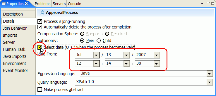

Next, we change the Valid From settings that are still identical to the version 1 values. Without this change, this would create a conflict when trying to install the both process versions on the server. Follow these steps:
  1. Expand ApprovalProcessV2 > Business Logic > Processes.
  2. Double-click the ApprovalProcess business process to open the business process editor.
  3. Switch to the Properties view and proceed to the Details tab for the process. This displays the Valid From settings.
  4. Uncheck the checkbox with label Select Date (UTC). The Valid From settings are grayed out.
  5. Check the same checkbox again. This refreshes the Valid From settings with the actual time, translated to the UTC format.

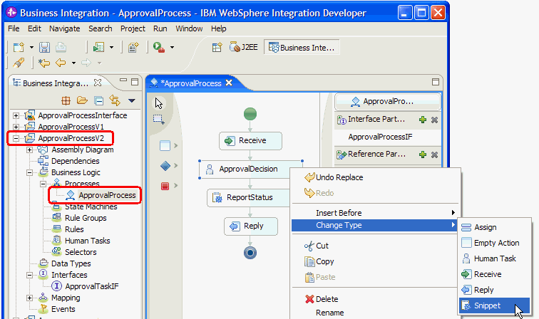

Now, we modify the business process to reflect the evolution of the process. Follow these steps:
  1. In the business process editor for the ApprovalProcess, right-click the activity ApprovalDecision and select Change Type > Snippet. If you need more details on how to implement Java snippets, refer to the Getting Started > Hello World sample.
  2. Select the snippet activity ApprovalDecision.
  3. Switch to the Properties view and proceed to the Details tab for the snippet activity.
  4. Switch the type of the Snippet activity to Java and add the following Java code:
  5. Approved = new Boolean(Math.random() > 0.6);

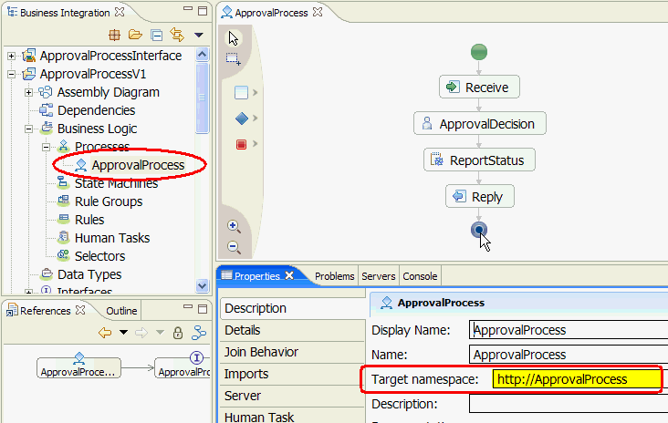

First, we find out the process component name of the version 1 process. As the version 1 exists in the workspace, follow these steps:
  1. Right-click ApprovalProcessV1 > Assembly Diagram and select Open With > Assembly Editor.
  2. Identify the process component name, circled red in the following screenshot:
  3. The process component name in this sample is ApprovalProcess, record it as you will need it later on.
  4. Close the assembly editor.
  5. Note: By default, the process component name is identical to the process name. However, for the case that these two names differ, it is important to do this lookup in the assembly editor as described here.
Next, we find out the namespace of the version 1 process. Follow these steps:
  1. Expand ApprovalProcessV1 > Business Logic > Processes.
  3. Switch to the Properties view.
  4. The target namespace is visible in the Description tab. In this sample, it is http://ApprovalProcess, record it as you will need it later on.
  5. Close the business process editor.

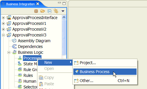

Next, we create the new version of the business process. Follow these steps:
  1. In the Business Integration view, expand ApprovalProcessV3 > Business Logic.
  2. Right-click Processes > New > Business Process.

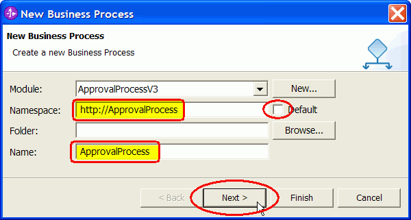

  3. In the New Business Process dialog, specify ApprovalProcess as name. By default, this will imply the appropriate process component name in the assembly editor later.
  4. For specifying the Namespace, uncheck the Default checkbox and change the value to http://ApprovalProcess.
  5. Note: Process component name and namespace must be identical to the values used for the version 1 definition, which is why we looked up the namespace value earlier.
  6. Click Next.

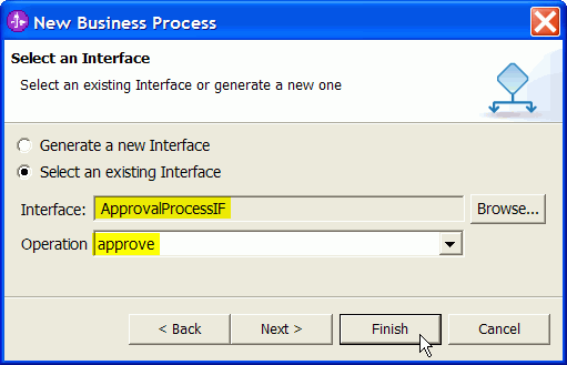

  7. In the Select an Interface dialog, choose Select an Existing Interface.
  8. Use Browse to select the ApprovalProcessIF interface and the approve operation.
  9. Click Finish. The business process editor opens.

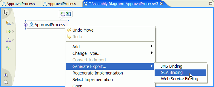

Now we are ready to finalize the module in the assembly editor. Follow these steps:
  1. Right-click ApprovalProcessV3> Assembly Diagram and select Open With > Assembly Editor.
  2. Drag and drop the ApprovalProcess to the Assembly Diagram: ApprovalProcessV3.
  3. In the Assembly Diagram, verify that the name of the process component is ApprovalProcess.
  4. Right-click ApprovalProcess and select Generate Export > SCA Binding.
  5. On the toolbar click the Save button and close the assembly editor.
