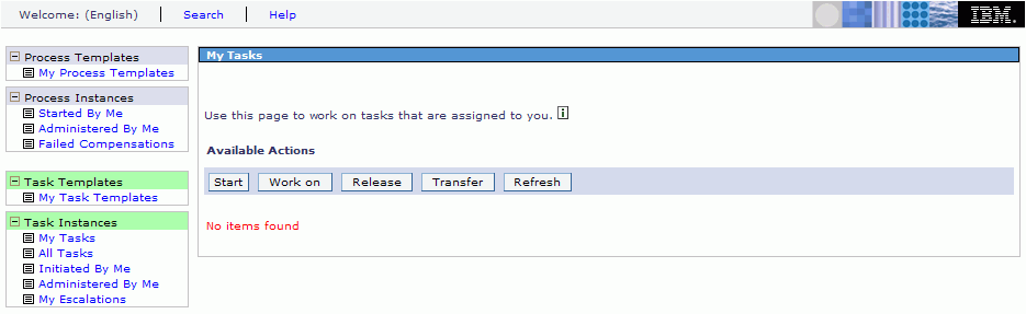

To start the BPC Explorer in the integrated test environment of your WebSphere Integration Developer, follow these steps:
  1. In WebSphere Integration Developer, switch to the Servers view.
  2. In the table, right-click WebSphere Process Server v6.0.
  3. From the pop-up menu, select Launch > BPC Explorer.
  4. If the login page is displayed, enter user ID and Password.
  5. The My Tasks view is displayed:
To start the BPC Explorer on WebSphere Process Server, follow these steps:
  1. In a web browser, open URL http://yourhost:yourport/bpc.
  2. Note: Replace yourhost with your server's internet address and replace yourport with the port of your server's HTTP transport, for example http://localhost:9080/bpc.
  3. If the login page is displayed, enter user ID and Password.
  4. The My Tasks view is displayed:

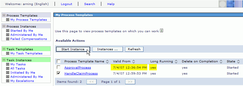

  1. Switch to the BPC Explorer.
  2. In the Process Templates section, click My Process Templates.
  3. The My Process Templates view is displayed:
    Note that for the template name Approval Process, the attribute Long Running shows the value yes.

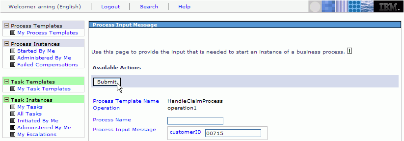

  4. Select HandleClaimProcess, and then click Start Instance.
  5. The Process Input Message view opens:
  6. Optionally, enter a Process Name.
  7. In the customerID Field, enter a value of type string, for example 00715.
  8. Click Submit.

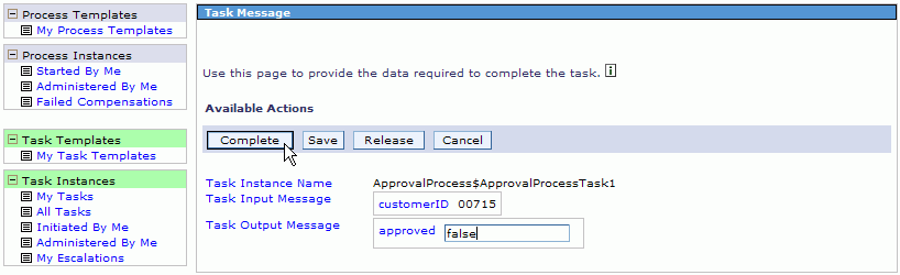

  9. Switch to the My Tasks view by clicking Task Instances > My Tasks.
  10. You should see a task in Ready state:
  11. Check the checkbox and click Work on. The Task Message window opens.
  12. In the field approved, either enter the value true or the value false and press Complete.
In the log file, you will find output similar to the output below.
[7/15/07 18:52:09:547 CEST] 00000081 SystemOut   O ApprovalProcess V1: result is false
[7/15/07 18:52:11:625 CEST] 00000081 SystemOut   O Mailing rejection to customer 00715
The business process is finished now and has been automatically deleted because the value yes is specified for the Delete on Completion attribute.

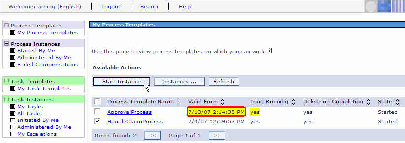

  2. In the Process Templates section, choose the My Process Templates view and click Refresh.
  3. The My Process Templates view is showing the actual list of templates:
    Note that for the template name Approval Process, the Valid From attribute shows a more recent value now. The attribute Long Running shows again the value yes.

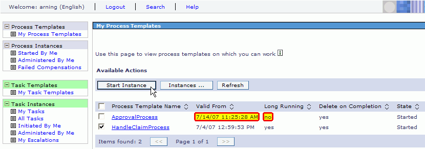

    Note that this time for the template name Approval Process, the attribute Long Running shows the value no, and the Valid From attribute shows another more recent value now.
