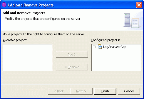

  2. Right-click the test server and select Add and remove projects.
  3. In the Add and Remove Projects window select LogAnalyzerApp and click Add.

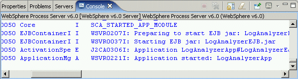

  4. Click Finish. Wait until the application has started.

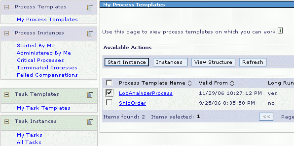

  1. In the BPC Explorer click My Process Templates.
  2. In the process template list, check LogAnalyzerProcess.
  3. Click Start Instance, click Submit, and then click My Tasks.

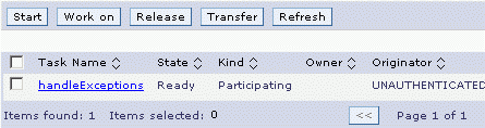

  4. Click Refresh until the handleException task appears.

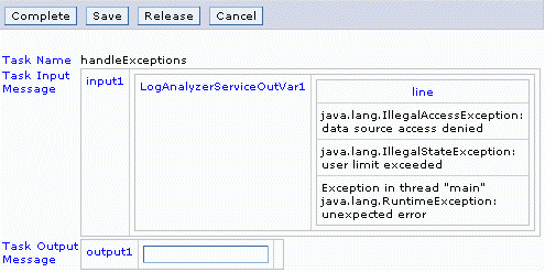

  5. Check the handleExceptions task and click Work on. The exception messages are displayed in the task input.
  6. Enter a task output message, for example, done, and click Complete.

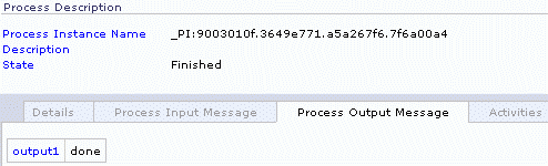

  7. Click Started By Me.
  8. In the list of process instances click the process instance name.
  9. Click Process Output Message to verify the process output.
