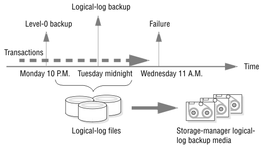

To illustrate, as Figure 2 shows, suppose you perform a level-0 backup on Monday at 10:00 P.M. and then back up the logical logs on Tuesday at midnight. On Wednesday at 11:00 A.M., you suffer a mishap that destroys your databases. You would be unable to restore the transactions that occurred between midnight on Tuesday and 11:00 A.M. on Wednesday unless you had continuous logical-log backup set up.
If the disks that contain the storage spaces with the logical logs are damaged, the transactions after midnight on Tuesday might be lost. To restore these transactions from the last logical-log backup, try to salvage the logical logs before you repair or replace the bad disk and then perform a cold restore.
Figure 2. Storage Space and Logical-Log Backups
begin figure description - This figure is described in the surrounding text. - end figure description
