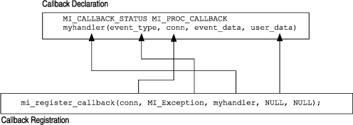

When you register a callback with the mi_register_callback( ) function, you provide arguments for most parameters of the callback. Figure 57 shows how a call to mi_register_callback( ) provides the arguments that initialize the parameters of the myhandler( ) callback.
Figure 57. Initializing a Callback
begin figure description - This figure is described in the surrounding text. - end figure description
The only callback parameter that the mi_register_callback( ) call does not initialize is the event-type structure (the event_data parameter in Figure 57). For more information about event-type structures, see Event Information.
