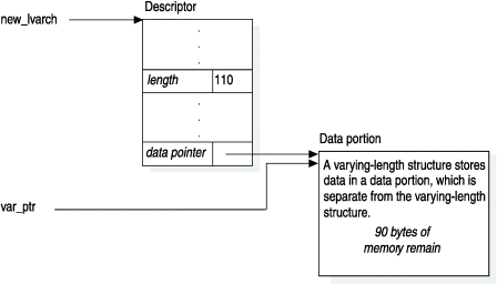

Figure 7 shows the format of the varying-length structure that new_lvarch references after the call to mi_set_vardata( ) successfully completes.
Figure 7. Format of a Varying-Length Structure
begin figure description - This figure is described in the surrounding text. - end figure description
The mi_set_vardata( ) function copies from the local_var buffer the number of bytes that the data length specifies. Your code must ensure that the data-length field contains the number of bytes you want to copy. In the code fragment in Figure 6, the data-length field was last set by the call to mi_set_varlen( ) to 110 bytes. However, if the mi_set_varlen( ) function executed after the mi_set_vardata( ) call, the data length would still have been 200 bytes (set by mi_new_var( )). In this case, mi_set_vardata( ) would try to copy 200 bytes starting at the location of the local_var variable. Because the actual local_var data only occupies 110 bytes of memory, 90 unused bytes remain in the data portion.

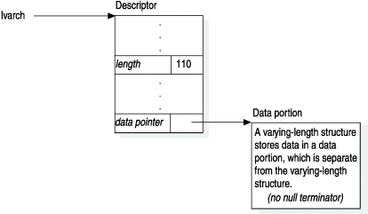

Figure 8 shows the format of the varying-length structure that lvarch references after the preceding call to mi_string_to_lvarchar( ) successfully completes.
Figure 8. Copying a Null-Terminated String into a Varying-Length Structure
The lvarch varying-length structure in Figure 8 has a data length of 110. The null terminator is not included in the data length because the mi_string_to_lvarchar( ) function does not copy the null terminator into the data portion.

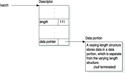

Figure 9 shows the format of this varying-length structure after the preceding call to mi_set_vardata( ) successfully completes.
Figure 9. Copying a Null-Terminated String into a Varying-Length Structure

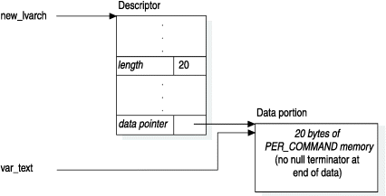

Figure 10 shows the format of the varying-length structure that new_lvarch references after the fill_buffer( ) function successfully completes.
Figure 10. Empty Varying-Length Structure
The varying-length structure in Figure 10 is empty because it has the following characteristics:

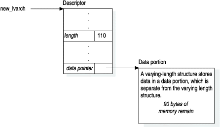

After you have an empty varying-length structure, you can use the mi_set_varptr( ) function to set the data pointer to the PER_COMMAND memory duration, as the following code fragment shows:
/* Set the length of the new varying-length data */
mi_set_varlen(new_lvarch, VAR_MEM_SIZE);
/* Set the pointer to the data portion of the
 * varying-length structure to the PER_COMMAND memory
 * that 'var_text' references.
mi_set_varptr(new_lvarch, var_text);
The preceding call to mi_set_varlen( ) updates the length in the varying-length structure to the length of 20 bytes. Figure 11 shows the format of the varying-length structure that new_lvarch references after the preceding call to mi_set_varptr( ) successfully completes.
Figure 11. Setting the Data-Portion Pointer in a Varying-Length Structure

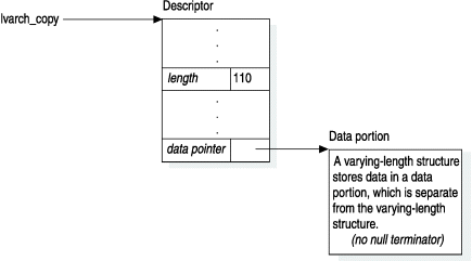

Copying Data into a User-Allocated Buffer
The mi_var_to_buffer( ) function copies the data of an existing varying-length structure into a user-allocated buffer. The function copies data up to the data length specified in the varying-length descriptor. You can obtain the current data length with the mi_get_varlen( ) function.
The following code fragment copies the contents of the varying-length structure in Figure 8 into the my_buffer user-allocated buffer:
mi_lvarchar *lvarch;
char *my_buffer;
my_buffer = (char *)mi_alloc(mi_get_varlen(lvarch));
mi_var_to_buffer(lvarch, my_buffer);
After the successful completion of mi_var_to_buffer( ), the my_buffer variable points to the following string, which is not null terminated:
A varying-length structure stores data in a data portion, which is separate
from the varying-length structure.

Copying Data into a New Varying-Length Structure
The mi_var_copy( ) function copies data from an existing varying-length structure into a new varying-length structure. This function performs the following steps:
  1. Allocates a new varying-length structure
    For the new varying-length structure, the mi_var_copy( ) function allocates a data portion whose size is that of the data in the existing varying-length structure.
    Server Only
    The mi_var_copy( ) function allocates the varying-length structure that it creates with the current memory duration.
    End of Server Only
  2. Copies the data in the data portion of the existing varying-length structure to the data portion of the newly allocated varying-length structure
    The mi_var_copy( ) function automatically copies the number of bytes that the data length in the existing varying-length descriptor specifies.
  3. Returns a pointer to the newly allocated varying-length structure as a pointer to an mi_lvarchar value
Suppose you have the varying-length structure that Figure 8 shows. The following code fragment uses the mi_var_copy( ) function to create a copy of this varying-length structure:
mi_lvarchar *lvarch, *lvarch_copy;
lvarch_copy = mi_var_copy(lvarch);
After the call to mi_var_copy( ) completes successfully, the lvarch_copy variable points to a new varying-length structure, as Figure 12 shows. The varying-length structure that lvarch_copy references is a completely separate structure from the structure that lvarch references.
Figure 12. Copying a Varying-Length Structure
Obtaining the Data Pointer
The mi_get_vardata( ) and mi_get_vardata_align( ) functions obtain the actual data pointer from the varying-length descriptor. Through this data pointer, you can directly access the varying-length data.
The following code fragment uses the mi_get_vardata( ) function to obtain the data pointer from the varying-length structure in Figure 7:
mi_lvarchar *new_lvarch;
char *var_ptr;
/* Get the data pointer of the varying-length structure */
var_ptr = mi_get_vardata(new_lvarch);
Figure 13 shows the format of the varying-length structure that new_lvarch references after the preceding call to mi_get_vardata( ) successfully completes.
Figure 13. Getting the Data Pointer from a Varying-Length Structure
