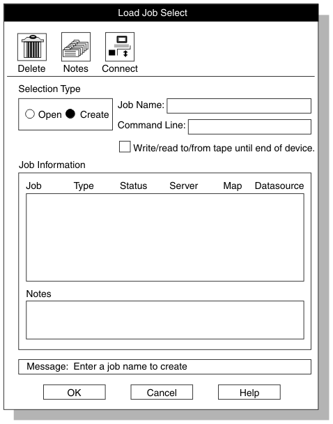

  1. Choose Jobs > Load from the HPL main window.
    The Load Job Select window appears, as Figure 108 shows.
    Figure 108. The Load Job Select Window
    begin figure description - This graphic depicts the ipload graphical user interface. The onpladm command line utility provides the same functionality. - end figure description
  2. Click Create in the Selection Type group.
  3. Select a name for the job and type it in the Job Name text box.
  4. Optionally check the Write/read to/from tape until end of device check box. For more information, see Specifying to Read to the End of the Tape.
  5. Click OK.
    The Load Job window appears, as Figure 109 shows.
