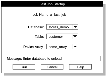

    The Fast Job Startup window appears, as Figure 117 shows.
    Figure 117. The Fast Job Startup Window for a Load Job
    begin figure description - This graphic depicts the ipload graphical user interface. The onpladm command line utility provides the same functionality. - end figure description
  9. Click Run to execute the job.
