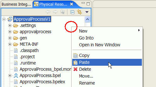

To copy version 1, follow these steps:
  1. Close all open editors.
  2. In the Business Integration view, right-click ApprovalProcessV1 > Show Files.
  3. Accept the warning that the physical resources view is intended for advanced users.
  4. In the Physical Resources view, right-click ApprovalProcessV1 and select Copy.
  5. Right-click on the white space in the Physical Resources view and select Paste.
  6. In the Copy Project dialog, change the proposed new name from Copy of ApprovalProcessV1 to the value ApprovalProcessV2.
  7. Close the Physical Resources view.

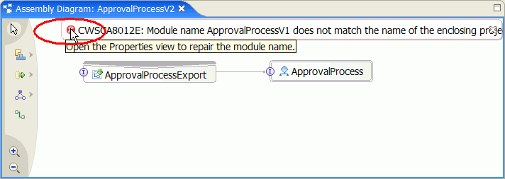

The new project is created, but you see an error symbol as we still need to synchronize the module name with the project name. Follow these steps:
  1. Right-click ApprovalProcessV2 > Assembly Diagram and select Open With > Assembly Editor.
  2. In the Assembly Diagram, click on the error message to open the Properties view for the module.
  3. In the Properties view for the module, click Repair name. This changes the module name to ApprovalProcessV2.
  4. On the toolbar click the Save button and close the dependency editor.
